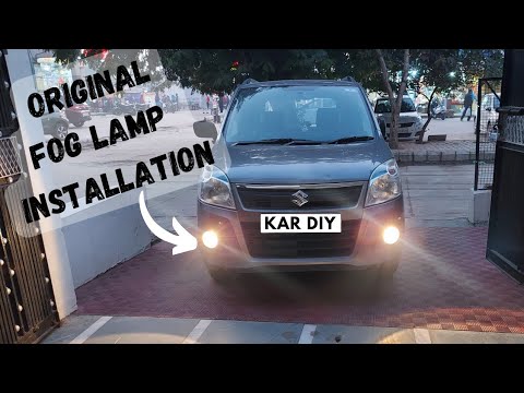

I’ve seen on YouTube videos that there’s housing to switch it on behind the wheel arch and it is easy to replace after removing the front wheel. But they’re only upgrading and there’s no blanks like we have.

EDIT : Official fog lamps with harness are here:
As far as I can tell the blanks in the front bumpers will be just blanks. There will not be any wiring harness etc.
However getting aftermarket or even OEM Fog Lamps and installing them should not be a problem.
Whether you go OEM or aftermarket its a personal choice. I have seen IPHcar fog lamps being installed in the Honda City and they were good.
Whatever you install ensure proper witing with fuses and relay to avoid and potential electrical problems and warranty issues.
Yes. Somehow I missed and this is the video - that looks complicated. Agreed on the fuses and relays. You think officially MS would put that on for us at the MASS?
Original fog lamps will definitely be available as spare parts and I am confident that they can be fitted on the Zeta model.
What will they cost with harness is something we will need to wait and watch.
Yes as noted above …wire tapping should not be allowed at any cost since it will lead to warranty issues and other electrical issues in future…foglamp should be installed with separate harness and the wiring should be propely fitted/tied.
