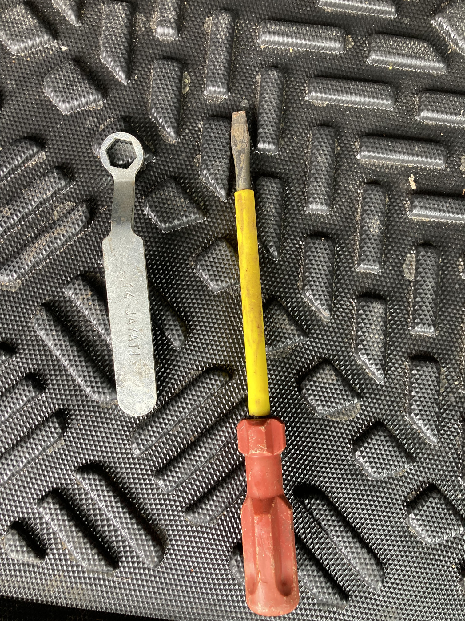

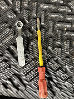

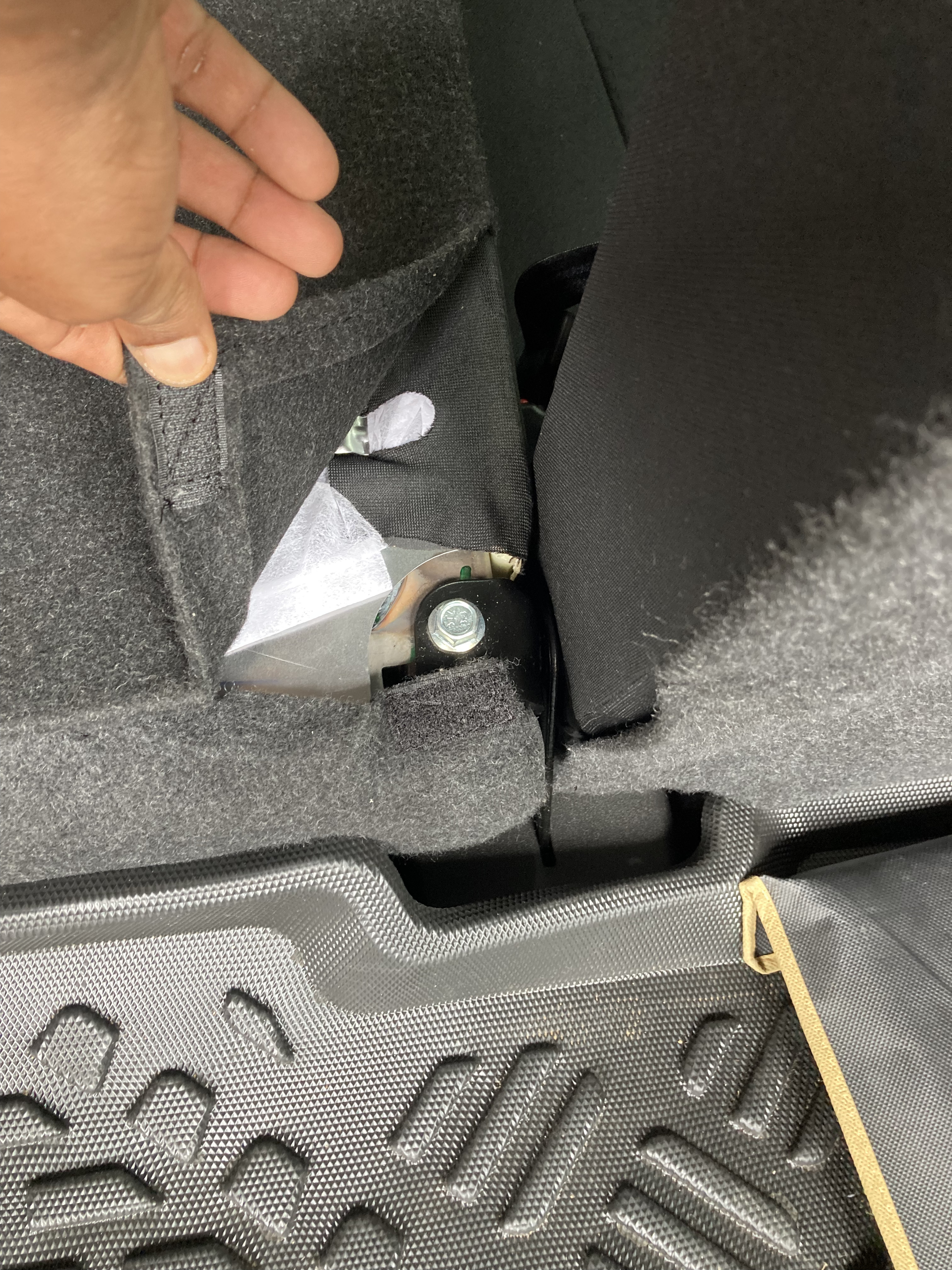

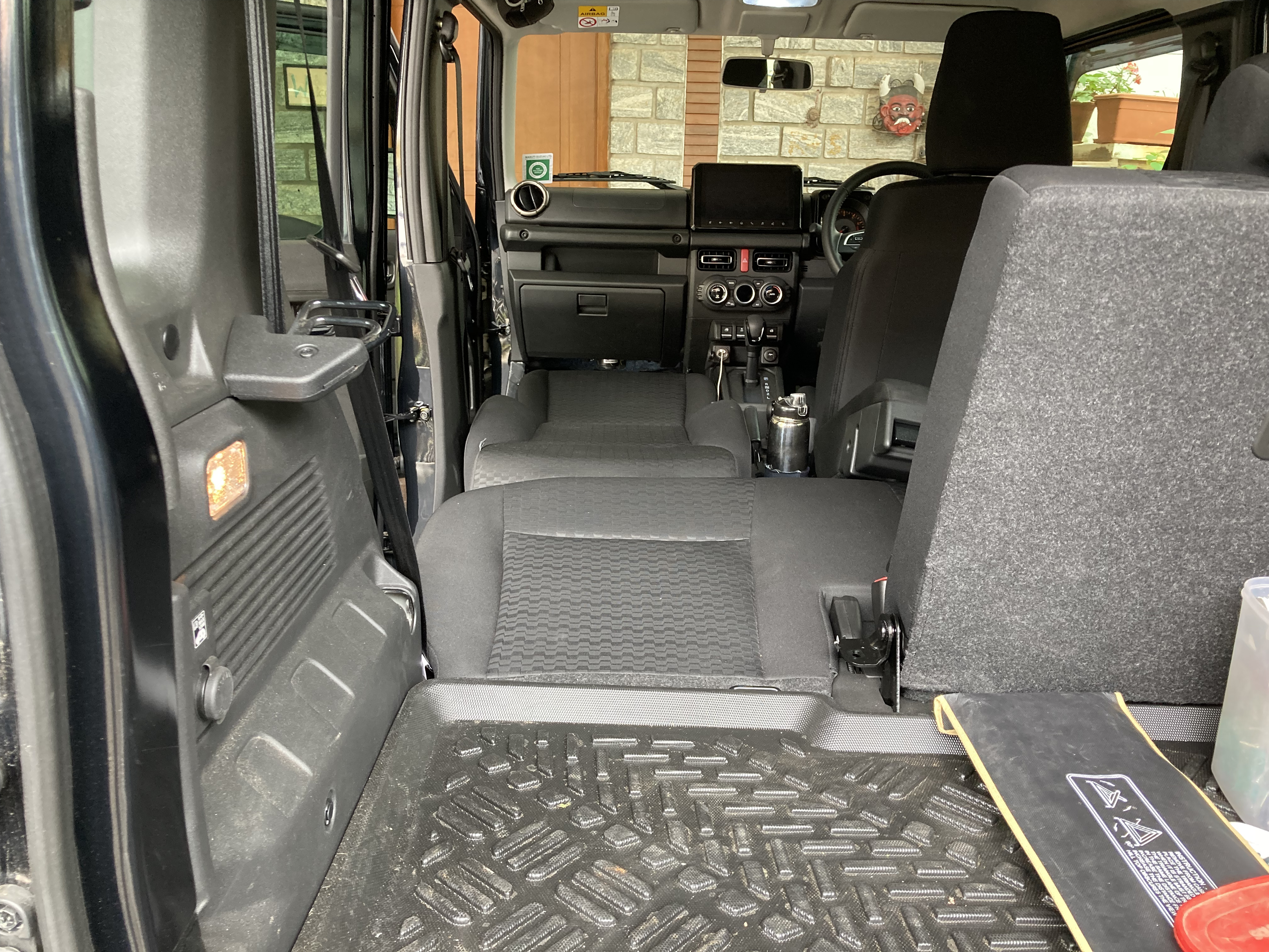

I wanted to see if I could convert the rear seats of my car into a 6 feet bed by removing the backrest. It turned out to be a quick and simple process that only required a 14-number wrench and a screwdriver.

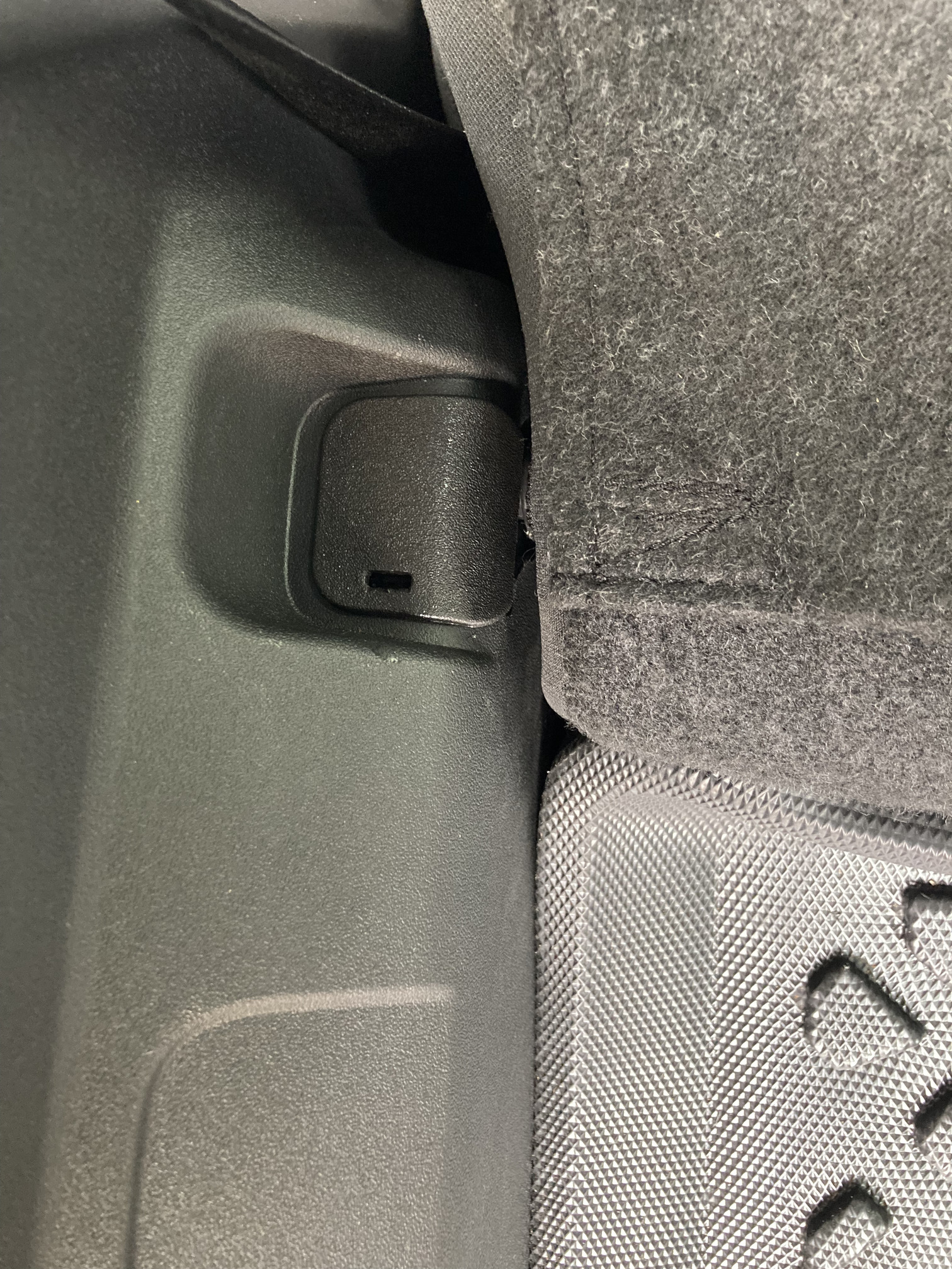

To start, I folded the seat forward, revealing a bolt on the lower right corner of the left seat and a plastic cover on the lower left corner with a rectangular hole. By pressing down on the screwdriver through the hole and angling it towards the back of the car, I could lift the plastic cover (which took a bit of experimenting the first time, but subsequent attempts only took about 10 seconds).
Once the cover was off, I opened the bolt and gently removed the backrest. This modification can be easily done even at a campsite. It’s important to note that the bed area may not be completely flat, but with some clever packing of bags and items, you can make it flatter and more comfortable for sleeping. Finding the right mattress for the space is essential to ensure a comfortable night’s rest.

Wonderful. Didn’t know it was so simple and easy to remove the back side of the rear seat. This can not only serve as a bed but also quick way to increase luggage area.

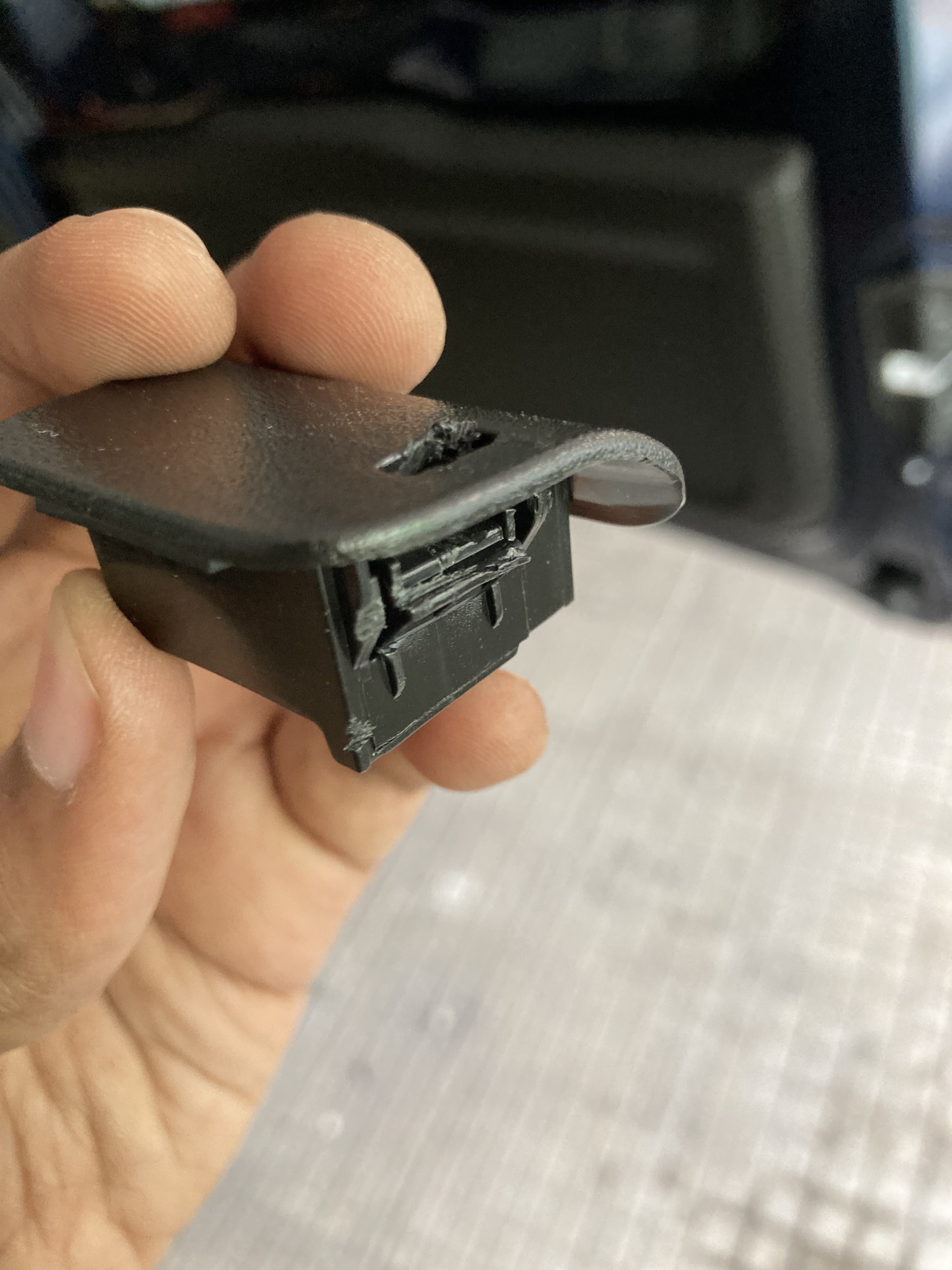

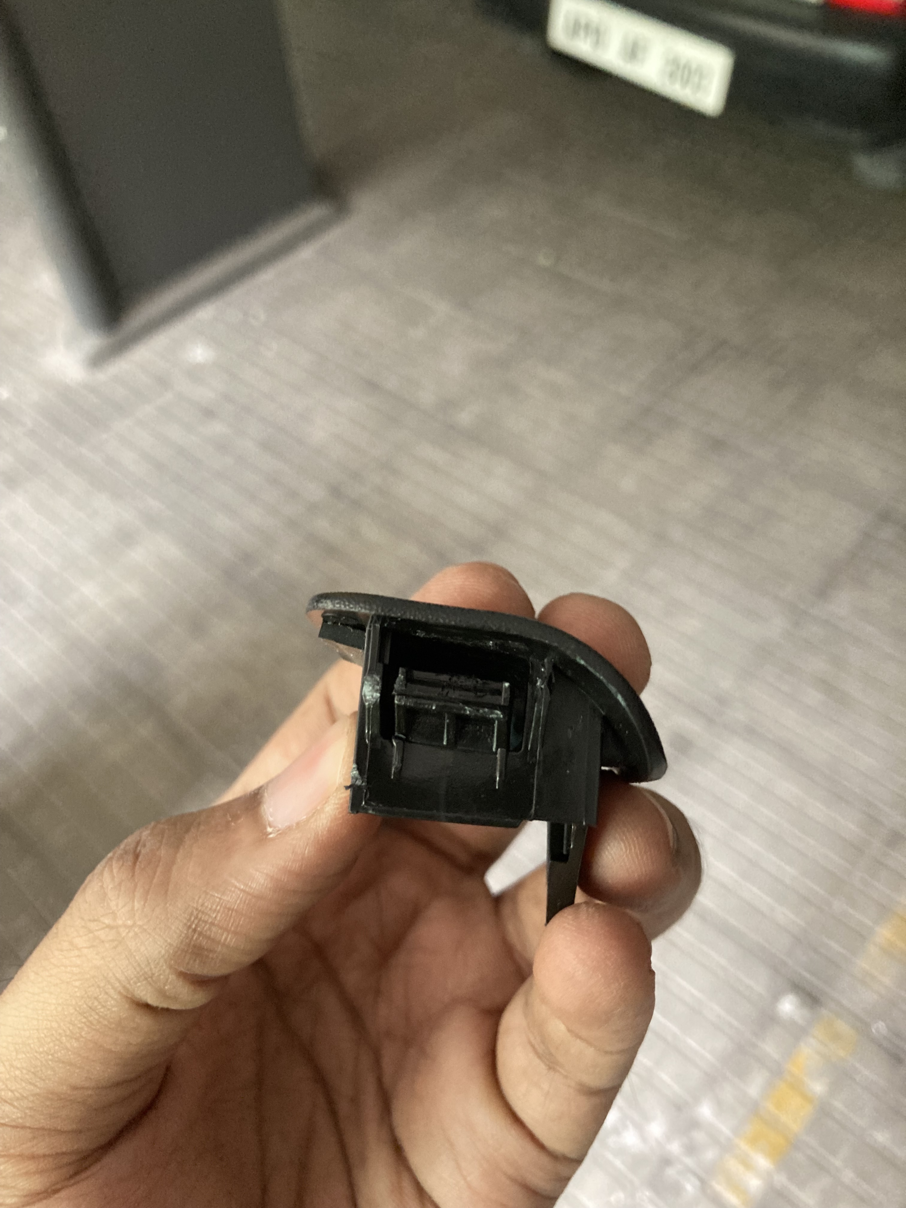

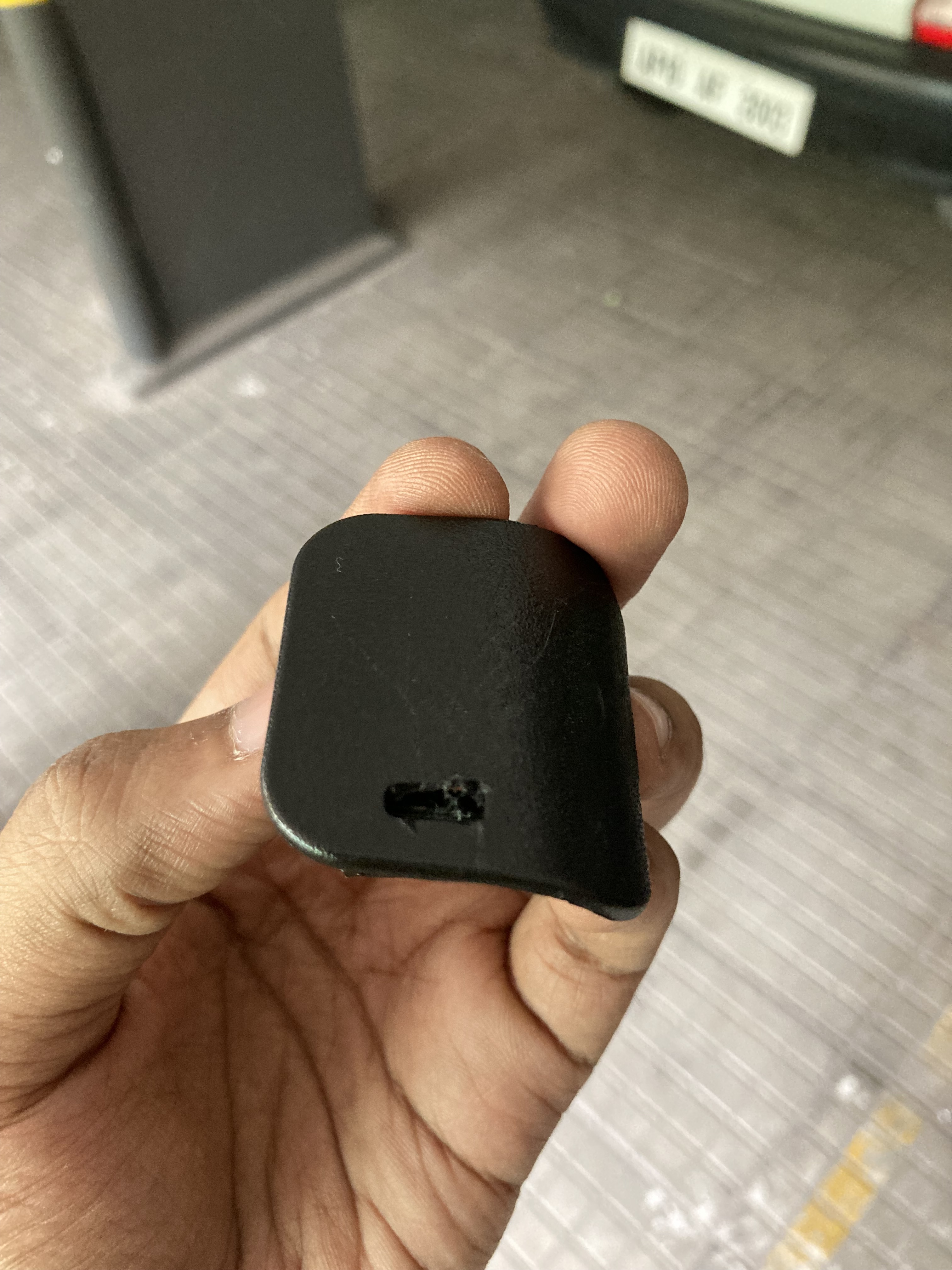

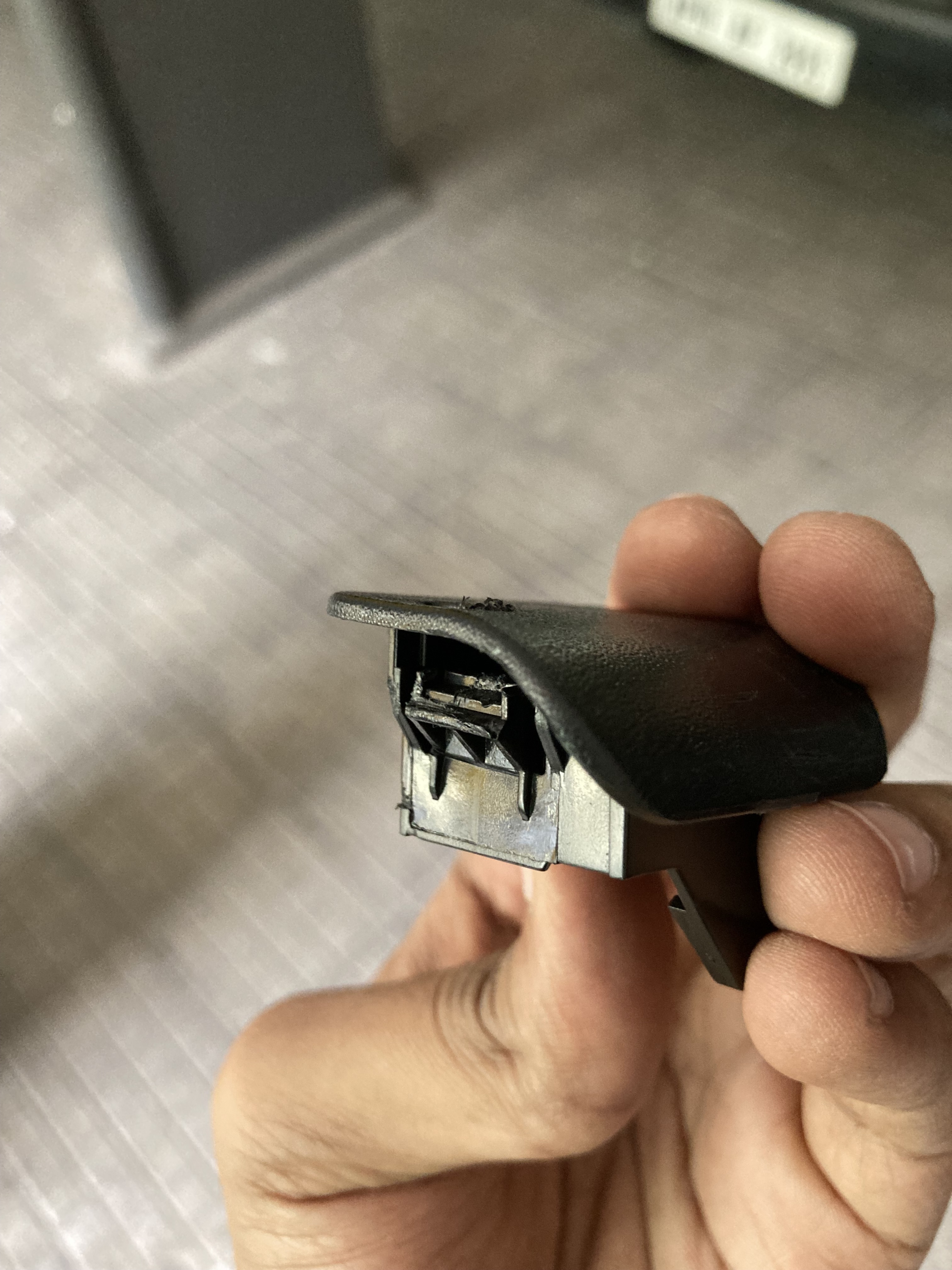

BTW folks I used a flat head and was unsuccessful in removing the plastic cover. Attaching images here. It’s a clip so use a flat thin screwdriver like a tester or something.
It’ll pop right out.
