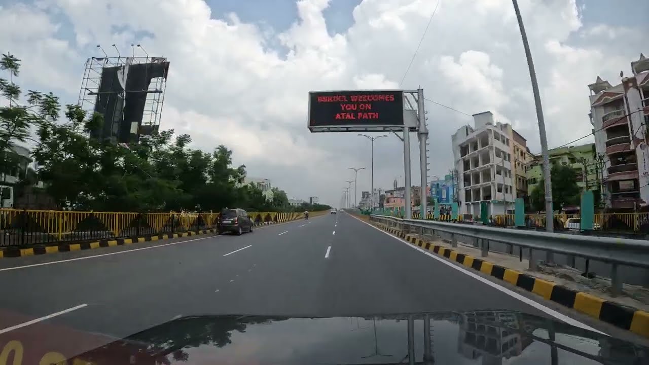

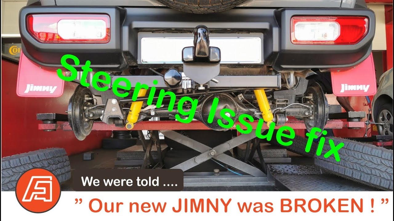

The alignment issue is there with stock tyres also. See an example
The steering alignment sensor and ESP sensor needs be reset and then the alignment be done. For late production batches, this was fixed from the Factory probably. Tyre upgrade talks for this issue are just excuses.
Also check.
