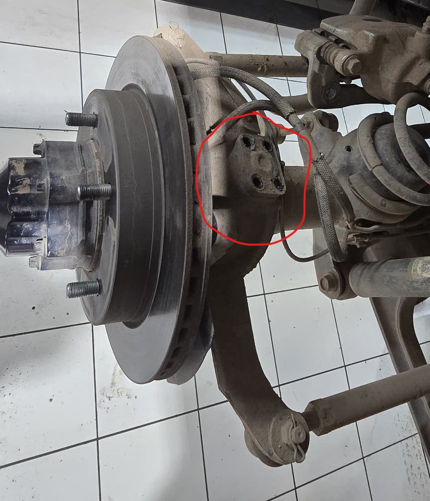

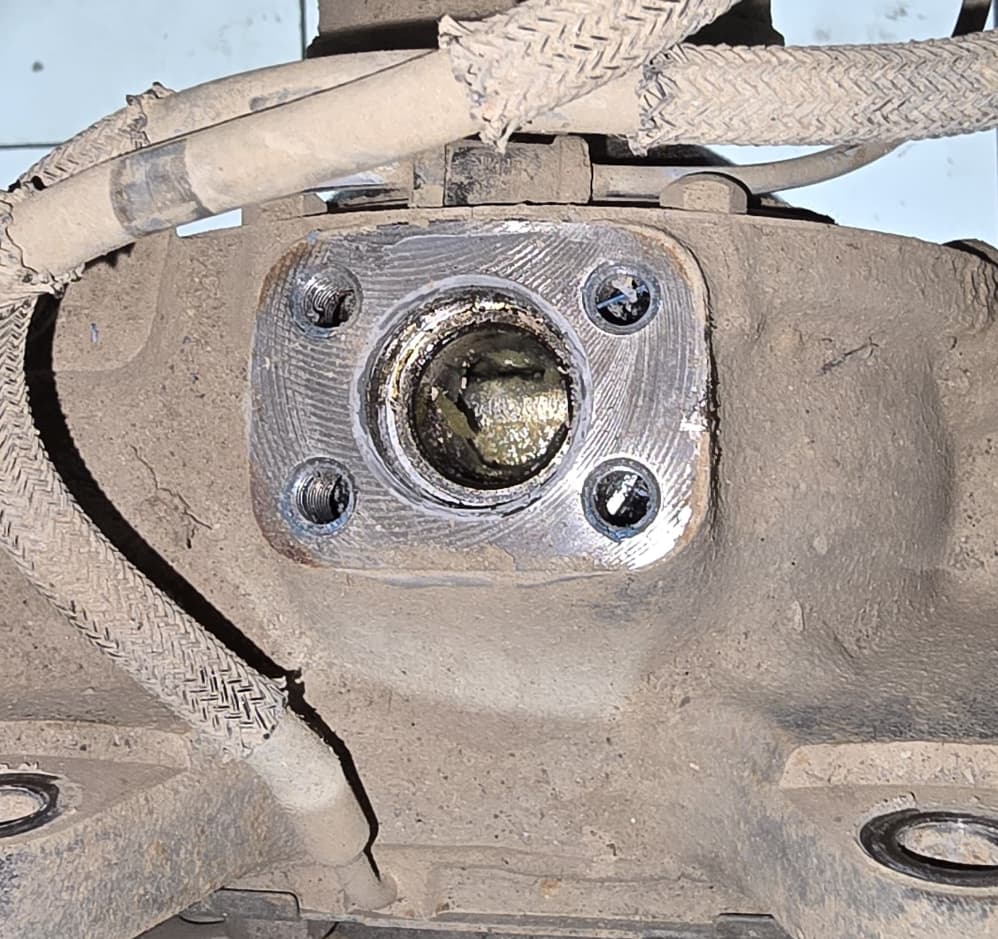

Jimny was lifted with wheels removed and then the 4 King Pins were removed.

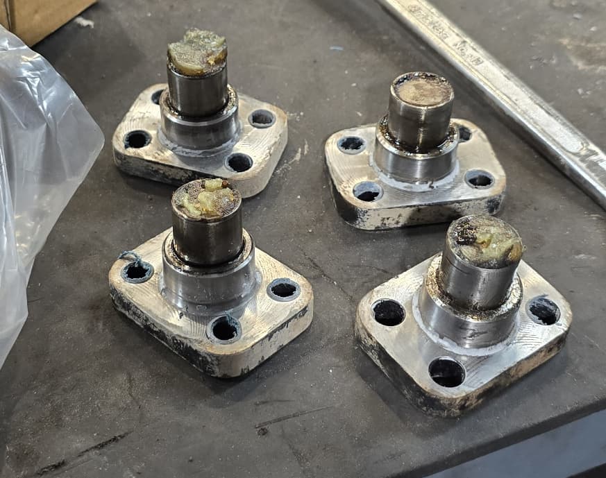

King Pin from top and bottom side removed:
Each wheel has 2 of these. One above and one below.
All 4 King Pins Removed:

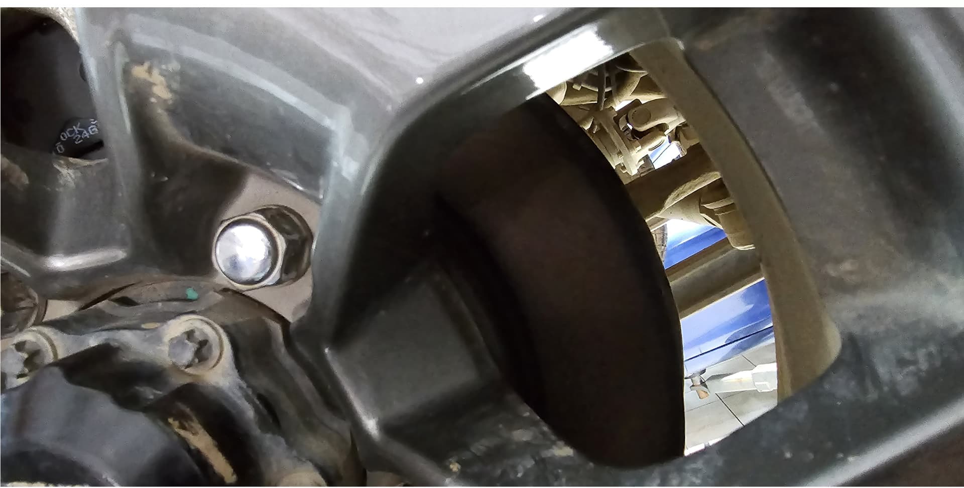

Both front Disc Rotors were replaced with the part shown below:
New Rotors Installed:
Again, we went for a long 30km test drive and this time there was no wobble / vibration.
